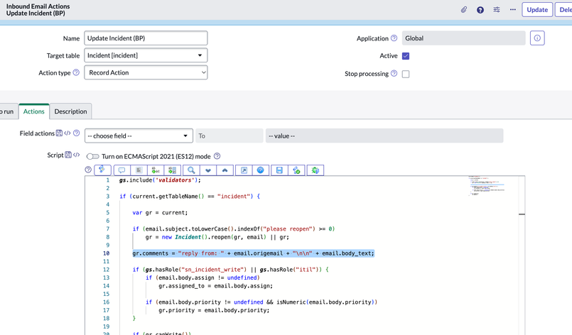

The reply is being mapped from the OOB Inbound action on the 10th line.

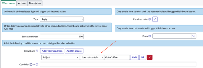

On top of this, you can write an IF Block, if the Subject does not contain "Out of office" or something like that which you in the Subject field of the Email.

I believe there is no need for scripting here.
In when to run, add the condition,
