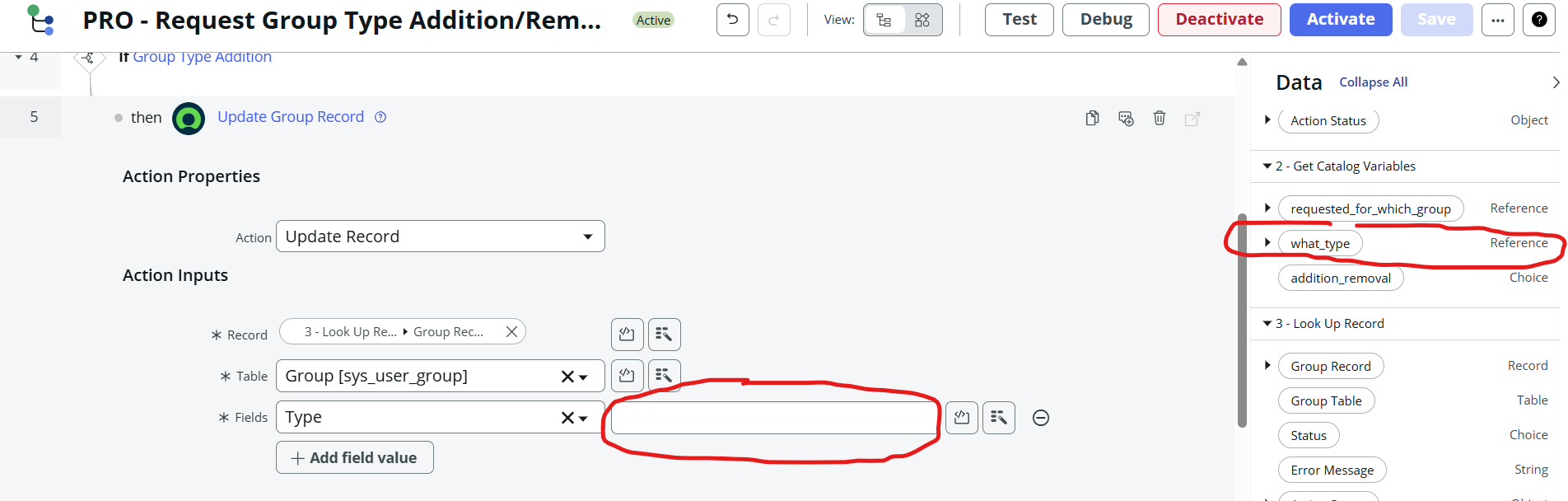

i need some help.  We have a catalog item for users to request if they want to add or remove group types like itil etc. The user puts the information in variables and after that i call them in the flow.
And how can i change the group type? If i select the table user group there is only a field Type. And in this field i cannot enter either the variable or the sysid of the variable.
Has someone a solution? Or an idea how i can automate it. It must be via Catalog Item the request.

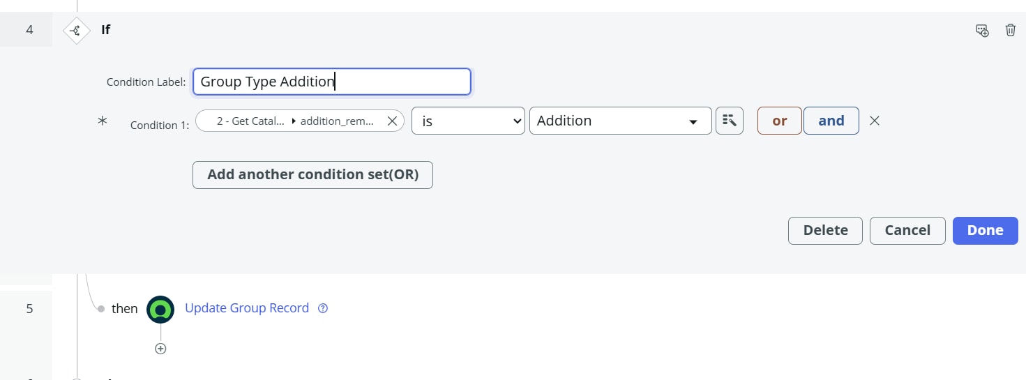

  3. Use a Flow Logic 'If' block: Drag the action_type variable into the condition to check if the user wants to "Add" or "Remove".

Hi Ponsekar,
thank you for your quick response. I will try this
I still have the problem with the type field see the attached pictures. Or maybe i got something wrong
Ah sorry i found it ok sorry, i didnt see the name property. This works
