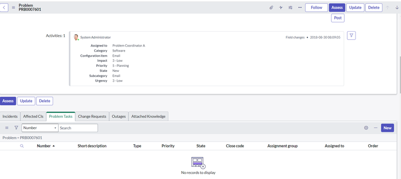

@Andrew_TND are you creating button on Problem record form to get problem tasks related to the same problem record ?
There is already a OOB related list "Problem Task" available on Problem record, you can use the same.
