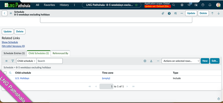

Dr Atul - LNG
HI @Sriram Pusuluri
If I am not mistaken, the holiday should be created under the child schedule, not directly in the schedule itself.
OOTB:
