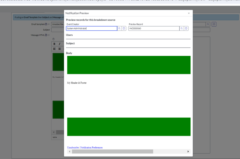

My client wants to have the header and footer of his notifications filled up completely in Green. Does anyone know how to do that?
Hi @jthomsen
Yes..you can do the following in Email Layout
Email Layout Record :
Step 1 : Create a table with single row in Layout field
Step 2 : Select the create row in layout and click on table icon (dropdown) and select Table properties
Step 3 : on Table properties select Advanced Tab & Put #00FF00 in Background color & click OK
You can follow the same step for footer as well
Put '${notification:body}' between header & footer
Layout should look like this :
That's it use email layout in Email template and email template in Notification...!!!
Final Result :
This is my Notification with template containing email layout
Previewed Notification :
Hope this helps.....!!!

Hi Vishal,
Yes exactly. Could you quickly explain me how to do it?
But it has to be on the email layouts not a specific notification
Hi @jthomsen
Final Result :
