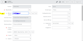

How to add phone icon in the place of info icon at right side of caller field
ā06-13-2022 04:42 AM

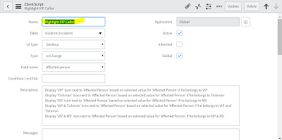

This explains how to display special icons on Incident form (Caller field) based on user profile settings.
Example :
If āAffected Personā belongs to āVIPā then display āVIPā icon image in āUsersā List view as well as on āIncidentā form
Solution
- Create a Client Script as shown below
- Upload the required icon image to System UI -> Images
- Write down below code under script.
if (caller.vip == ātrueā) {
callerLabel.setStyle({backgroundImage: āurl(images/icons/vip.gif)ā, backgroundRepeat: āno-repeatā, backgroundPosition: bgPosition, paddingLeft: ā30pxā });
- Whenever āAffected Personā field value is selected, if the selected user belongs to āVIPā then āVIPā flag will be shown on Incident as shown below.

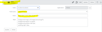

- To display the icons in List view , Below are the steps
- Goto Sytem UI -> Field Styles
- Create new one as shown below
- Below is how shown in List view.
