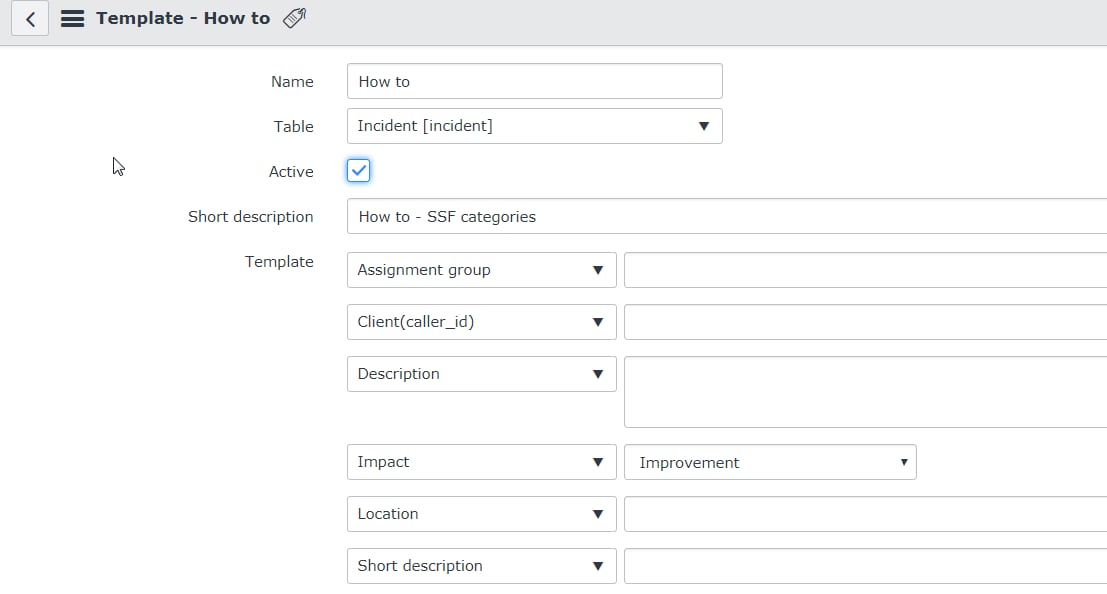

There is another option that will not require scripting, please check it below
1. Create a new template and add all the details you need.
2. Schedule the template for execution on a monthly basis
Let me know if you more details how to set it up.
