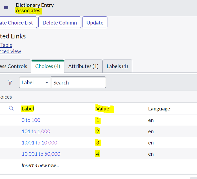

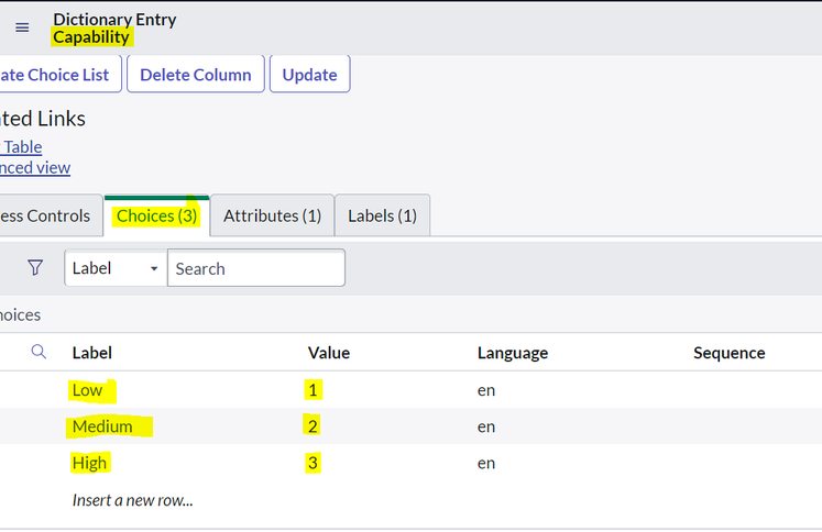

For assigning the points to choices you can do like below if you are using choice type field.
So that it will give choice values when we are using g_form.getValue("fieldname") in client script.
11-12-2022 08:03 AM - edited 11-12-2022 08:37 AM
@Murthy Ch these choices are reference choices..,and how choice values act like points..
