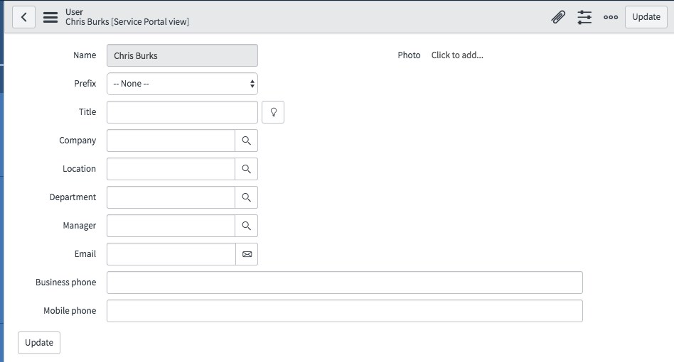

One quick way of doing it is to follow these steps:
1) Navigate to the sys_user table and open a record
2) Click on the hamburger icon to the top left of the form and select "View > Service Portal"
3) Again click on the hamburger icon and this time click on "Configure > Form Layout"
4) From the left side move Time Zone to the right
5) Now navigate to the Service Portal User Profile page

Yayy!! This is really quick and helpful. Thanks a lot Chris
