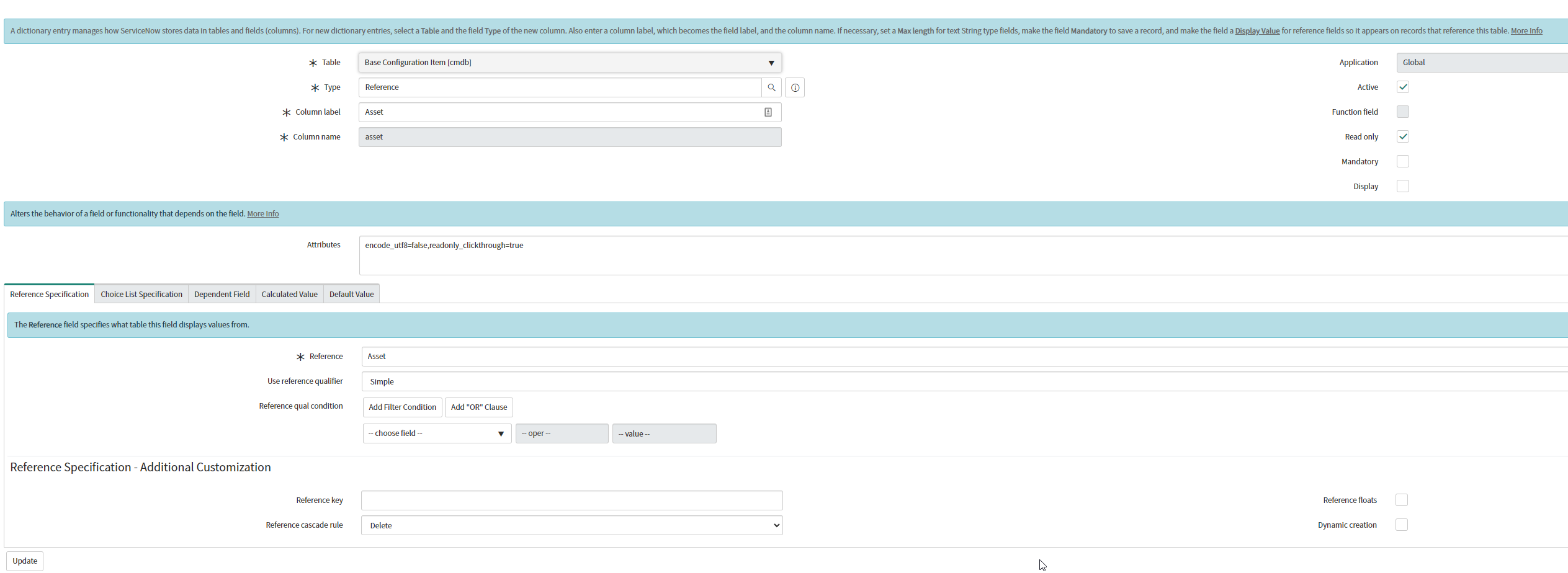

This is what I see on the field settings
I feel like it is putting data from a custom field I made on the ALM table into it, but still testing that theory.

OK, so found an oddity and seeing how it works.
We have a custom field on the ALM_HARDWARE table called MLSE Refresh, this is where we are noting when the hardware should be replaced.
What we have noticed is anything entered into this field, is then transposed into the Asset column
Any ideas what is causing that?
This is because "Display" is checked.  You should only have one field with "Display" checked per table, and that is the field that gets displayed in reference fields, or the top of the form, or when using .getDisplayValue() in scripts.
