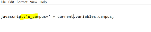

Hi @Gian1
Ok got it...
reference qualifier should be highlighted in below screenshot
Actually , colon (:) will get converted here in community text editor.
09-19-2023 07:50 PM
Hi @Gian1 ,
You can use Advanced reference qualifier on "Exam Room Location" field
javascript : 'u_campus=' + current.variables.campus;
u_campus - field from cmn_location
campus - variable from catalog item // use your variable backend name
