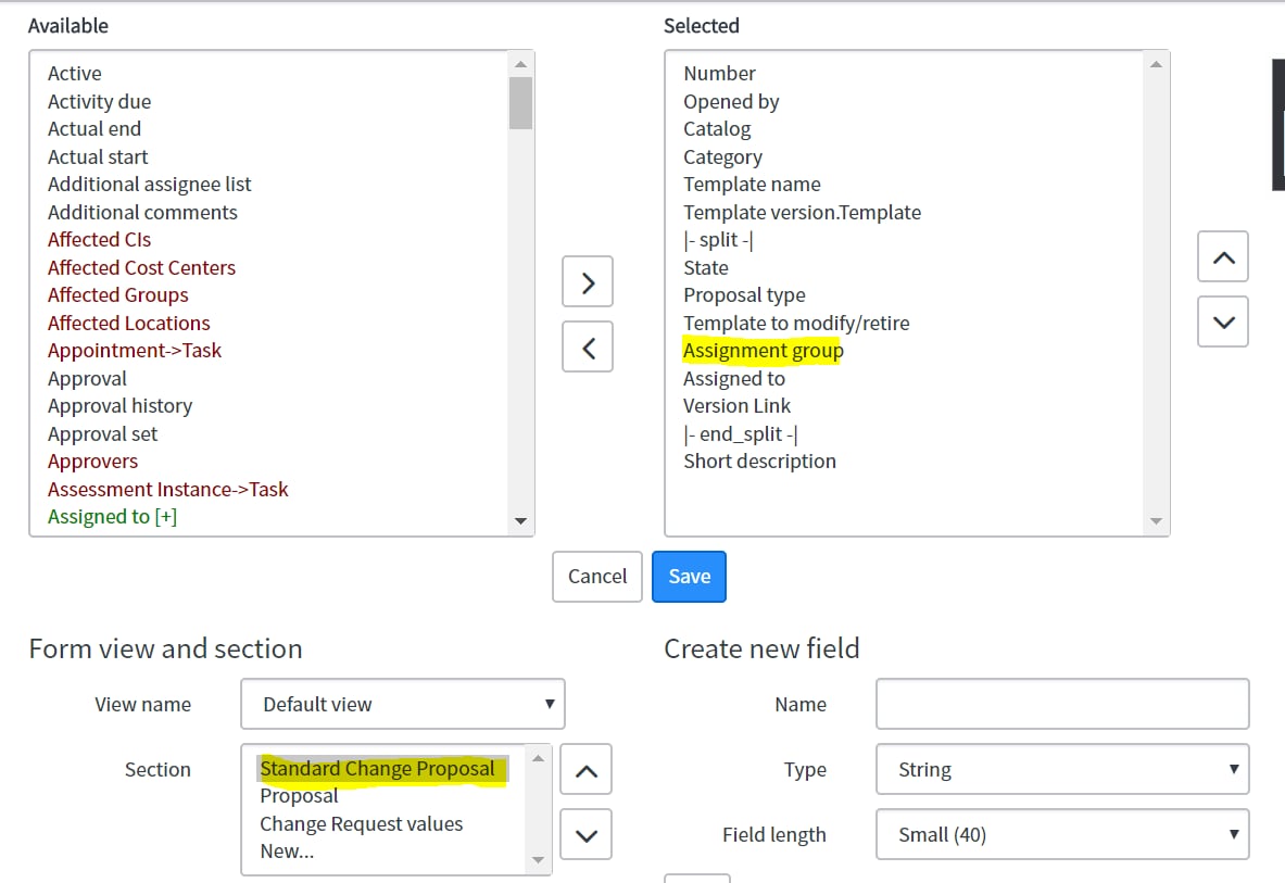

Thanks for the response. I do not want to add the Assignment Group field in the Change Request Values section as that is already available in the Standard Change Proposal section as below:
What I wanted to achieve is when proposing a new template, there is a Change Request Values field that is using a template and one of the fields in the template is the 'assignment group' as shown below:
So whatever group they put in the assignment group for the proposal template, I want to get that value and pass over to the 'assignment_group' in the Standard Change Proposal.
