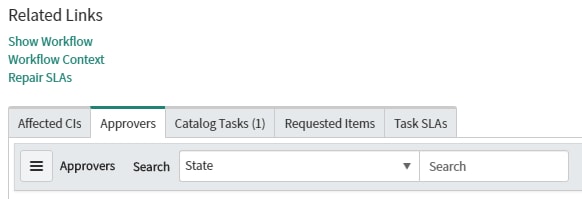

Hi @Ankur Bawiskar ,
Unfortunately it is working only on incident, problem section.
It is not working on affected CI, Requested items  related list .
Also the section is not working on few of the sections.
I have written proper syntax and table name.
g_form.setDisplay('opened_by',false);
g_form.setDisplay('u_owner', false);
g_form.setDisplay('u_business_process', false);
g_form.setDisplay('u_delivery_approval', false);
g_form.setDisplay('approval', false);
//g_form.setSectionDisplay('Manualapproval', false); // name of section
g_form.hideRelatedList('incident'); // name of related list
g_form.hideRelatedList('problem');
g_form.hideRelatedList('change_request');
g_from.hideReleatedList('sc_req_item');
g_form.hideRelatedList('task_sla');
g_form.hideRelatedList('task_ci');
g_form.hideRelatedList('sysapproval_approver');
g_form.setDisplay('u_vendor_id_reference', false);

@Ankur Bawiskar
Also if I write a UI policy or Client script when the form is loading at that moment it shows all the fields and once the form is loaded it shows the correct ones. so how can we fix this ? Do we need to use a BR instead?
On the Requested Item form below are not working, Also attaching the screenshot below:
