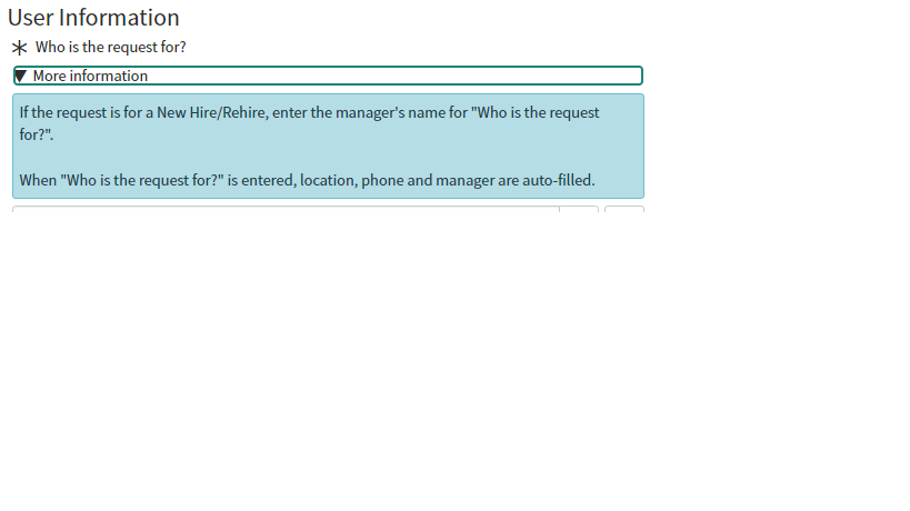

I have 1 variable in a variable set.
And this variable set is used in 100 catalog items.
For 1 catalog item, "help text" in a variable(requested for) should not be there.

hi Anil,
I need to remove "help text" not the field message.
It is not possible to show/hide Help text based on condition. You can create duplicate variable and show this new variable using client script for specific catalog item. And hide old variable on your catalog item.
