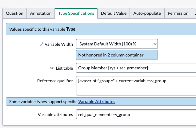

Get rid of the data lookup policy, and/or whatever else you have in place to populate the value of the variable.  All you need to do in this case is change the reference qualifier on the list collector variable based on the value of the select box variable(s), and whatever the relationship is between that value and the list collector table.
As a simple example, I have a select box variable named v_group that has 3 choices with values that are the sys_id of the group.  My List Collector variable List table is the sys_user_grmember table.  I only want to be able to select group members (users) that belong to the group I selected, so my Reference qualifier and Variable attributes look like this:
this works because the group field on sys_user_grmember is a reference to the sys_user_group table, so its value is a sys_id.  The variable attribute ensures that the list filter is updated when the select box value changes.

Thanks for your help Brad! This works like a charm!
