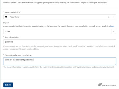

Is someone able to tell me how I can make the the details entered into the Short Description field when logging an incident via the Service Portal display possible knowledge articles solutions that may assist the user to solve the issue themselves?

Re you saying it works on the backend and not on service portal?
Because it should do there as well.

No, I didn't have much luck. I went back to the company that did our original install and asked them and they told me that we need to make changes to the widget in the Service Portal. I have not taken it any further yet. If you work it out let me know.
12-18-2017 06:16 AM
All you need to do is download widget xml from the below link and use that widget in contextual search results variable
ServiceNow KB: Contextual search on record producers does not work in Service Portal (KB0610534)
