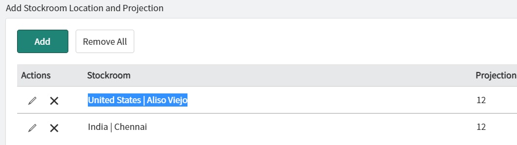

what is the variable type for account?
can you share variable configuration image for stockroom within MRVS?
which field in alm_stockroom holds the Country | Location data?
use that in the script then

            str = str + "Stockroom: " + gr.yourField + " Projection: " + parser[i].projection;
