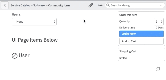

‎03-03-2019 05:55 AM
Once the page is rendered you should interact with the UI page with normal javascript if you're trying to change a client side item such as an icon.
Here is an example:
UI page HTML/XML:
<h3>UI Page Items Below</h3>
<hr/>
<span id="icon1" class="icon-clear" style="font-size: 24px"> <span>User</span></span>
</j:jelly>
Catalog Client Script:
if (isLoading) {
return;
var sample = document.getElementById('icon1');
if(newValue == ''){
sample.className = '';
sample.classList.add('icon-clear');
return;
sample.classList.add(newValue);
// Any of these techniques would work too:
// var sample = gel('icon1');
// var sample = $j('#icon1')[0];
// var sample = g_form.getElement('icon1');
// var sample = icon1;
