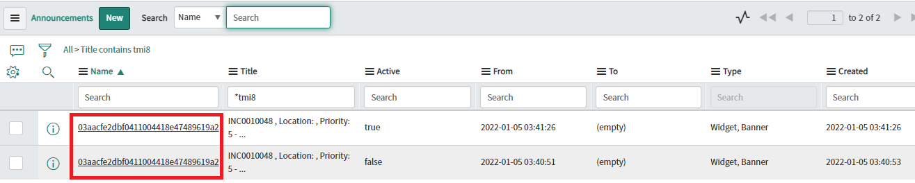

‎01-05-2022 03:44 AM
Yes.
The sys_ids in announcement record and logs is the same.

Announcement records-
‎01-05-2022 04:29 AM
As I told the update from 2nd BR might be causing the 1st BR to run and insert
try to adjust 1st BR condition to check if record already exists or not
if not then only create new record into announcement table
