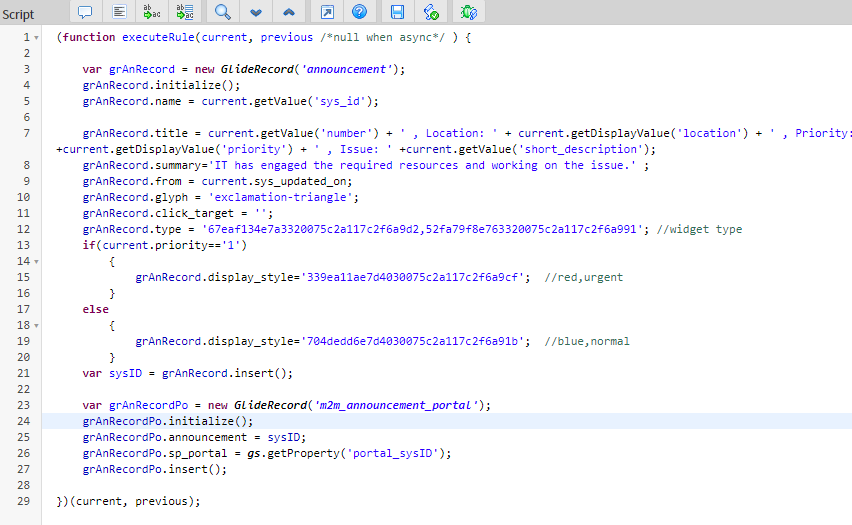

I have created a BR to create announcement which is perfectly working fine.
Below is the BR to create incident announcement-
Type- Async, insert, update. Condition- when major incident state is accepted.

As I told the update from 2nd BR might be causing the 1st BR to run and insert
try to adjust 1st BR condition to check if record already exists or not
if not then only create new record into announcement table

Actually 2nd BR works and announcement record sets to active=false. But the incident announcement is still shown in portal. When i set the state to resolved, a new record is created in announcement which is made false. This should not be the case.
The first announcement record created when incident was promoted to Major incident, that should be made inactive.
I think the issue is- whenever i update something in incident, a record is created in announcement. So due to duplicate announcement records referring to same incident is causing an issue.
Am i correct?
Check below screenshot-

I tried after, update BR. But what is happening is- when i change the state to resolved, it creates a new record in announcement table which is true, and the previous record which was created when incident was promoted to major incident, that record is made false.
As the new record is true, thats the reason incident is still shown in portal.
It should not create a new announcement record, when i change the state to resolved.
Check below ss-
