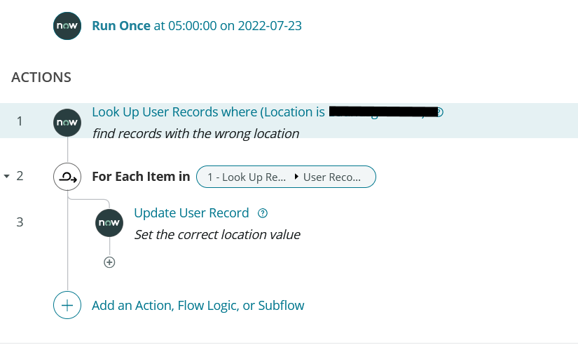

I can show how a Flow would be configured to update records pointing to the wrong location, example below.
