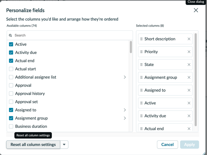

HI @Sriram Pusuluri ,
If you impersonate any user or for other users if it is not getting reflected,
Click on personalize fields and reset all column settings

and don't forget @Sriram Pusuluri.
If you ever personalised your list view and then the default one was changed, then you need to restore back to default to see that change:
It has happened to me when i was doing similar thing but on dmn_demand table today :))
