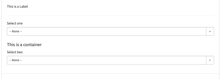

Hi Team,
 How to remove space after the label variable.
I want to align the form like below.
Uma.
Michael Jones -
Instead of using a variable of type "Label" trying using a variable of type "Container Start" and check the box for show title.
If this is only used in the portal, this should be fine. If it's used in the UI, then you would either need to put an end container right after it (or actually setup the containers the way you want them as these add + / - sections that can be collapsed or expanded).
Hope this helps!
