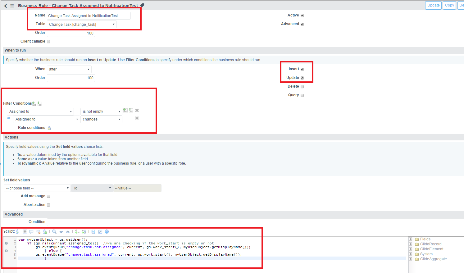

Hello everyone,
I am trying the following step #2 suggested from Justin:
Created the Business Rule with the following code
var myUserObject = gs.getUser();
if (gs.nil(current.assigned_to)){ //we are checking if the work_start is empty or not
gs.eventQueue("change.task.not.assigned", current, gs.work_start(), myUserObject.getDisplayName());
} else {
gs.eventQueue("change.task.assigned", current, gs.work_start(), myUserObject.getDisplayName());
Created an event name in the registry
Created the notification for the event item
also tried to set the "send when" to "Record inserted or updated"
and I noticed when I try to check mark "event parm 2 contains recipient" it doesnt stay saved:

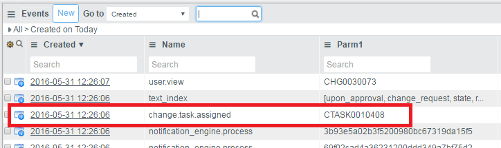

When I try creating a change task, it creates the event but doesnt send an email to who the change task is assigned to:
The assigned to person has an associated email address on their sys_user table.
Any help would greatly be appreciated.
