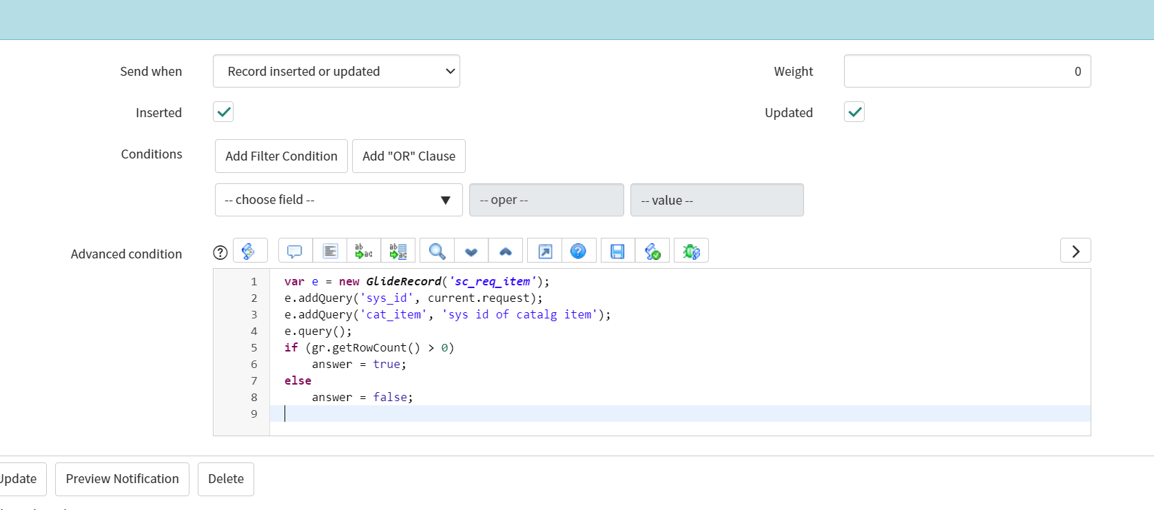

Oh ok , try this in advance condition of notification
Code:
var e = new GlideRecord('sc_req_item');
e.addQuery('sys_id', current.request);
e.addQuery('cat_item', 'sys id of catalg item');
e.query();
if (gr.getRowCount() > 0)
answer = false;
else
answer = true;

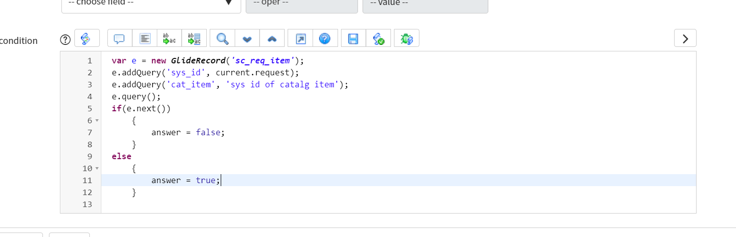

ā08-09-2022 08:43 AM
Sorry one small mistake I made I have corrected below
e.addQuery('request', current.sys_id);
e.query();
if (e.getRowCount() > 0)
answer = false;
else
answer = true;
ā08-09-2022 08:39 AM
You can use advanced script in your notification:
var scReq = new GlideRecord("sc_req_item");
scReq.addQuery('request', current.getUniqueValue());
scReq.addQuery('cat_item', 'sys_id_of_catalg_item');
scReq.query();
if (scReq.next()){
answer = false;
else{
answer = true;
ā08-09-2022 08:45 AM
@sai
Check the correct script above in my reponse
Hi Sai,
You need to go to your notification on sc_request table and in the advanced condition section you can write the below script:
var ritm = new GlideRecord('sc_req_item');
ritm.addQuery('request', current.sys_id);
ritm.addQuery('cat_item', 'Sys_id of catalog item');
ritm.query();
if (ritm.nex()) {
answer = false;
} else
answer = true;
Please mark this as correct and helpful if it resolved the query or lead you in right direction.
