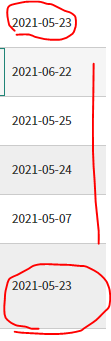

Thanks for your response @Sharath Allam
used below filter condition....no results...but at 30th day there are due dates...attaaching both the screenshot...please check and help me
None of the above records have the due date after 30 days.
