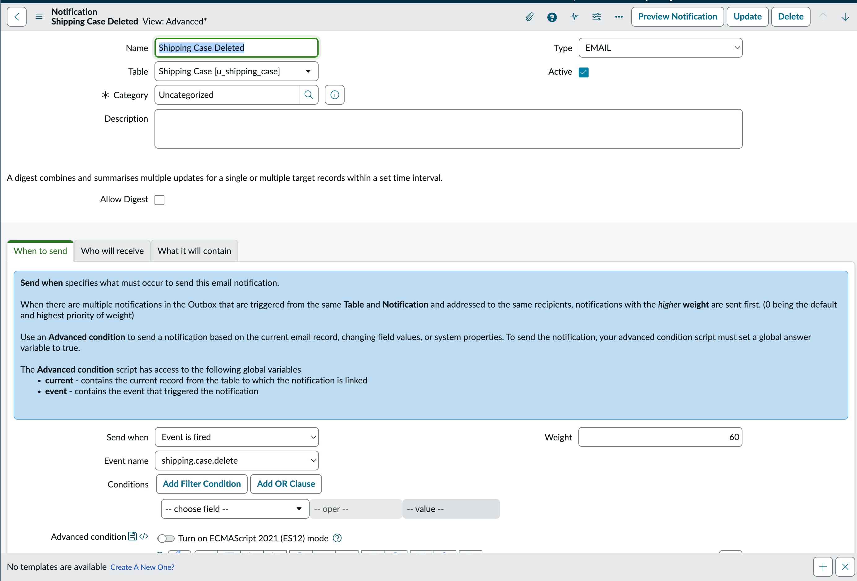

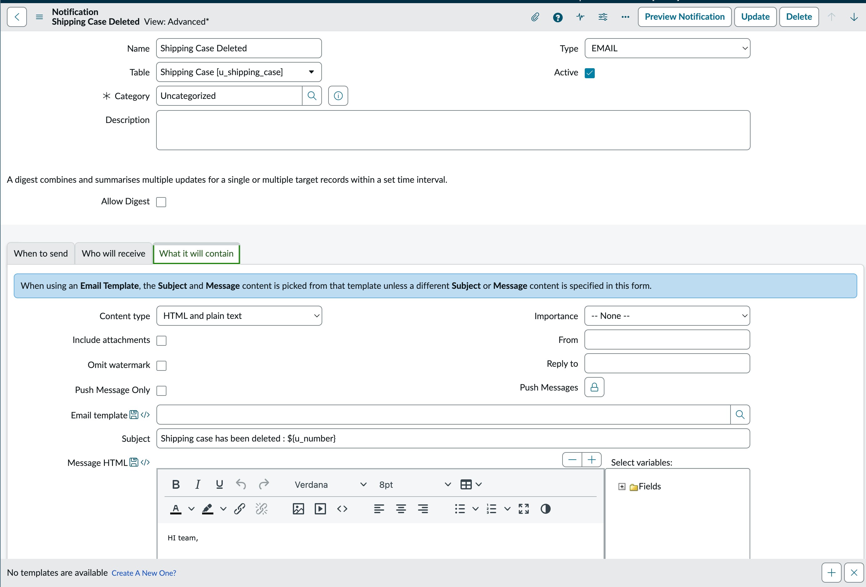

I’ve already tried the approach you suggested. The issue I’m facing is that when I delete a record from the Shipping table, the event fires successfully (I can see it in the Event Log), but there is no corresponding entry for the notification in the Email Log.
My requirement is quite simple:
I just want a basic email notification whenever any record is deleted. In the email subject, I’m only using the record number to identify which record was deleted, so I’m not using any email script or advanced logic.
I’ve attached a screenshot for reference. Could you please let me know what I might be missing or misconfiguring?
