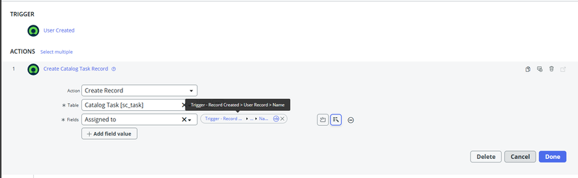

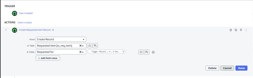

Hi @sath
I tried your requirement.But,i am not sure  your requirement details are correct or not you provided.It was worked ,but what do you choose on the record in sc_task table
If it is not not your expectation ,can you provide the details more.
