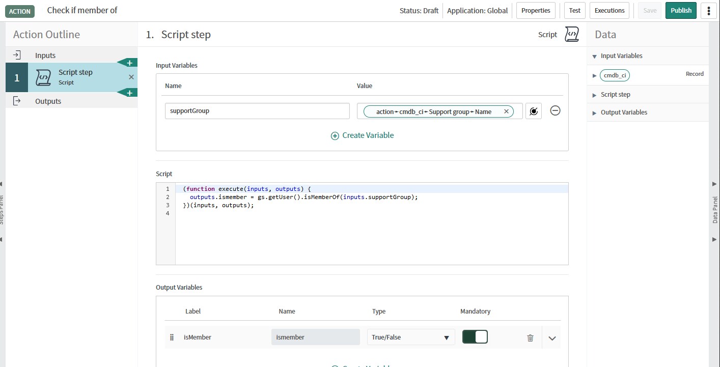

How to use if condition of following script in flow designer. gs.getuser().ismemberof('current.cmdb_ci.support_group')

Tested with below.
1. Inputs: cmdb_ci is of type "Reference.Configuration Item"
2. Script step: Input Variable name is "supportGroup" and Value is "action -> cmdb_ci -> Support group -> Name". I just selected it from data pill on the right side of the page under "cmdb_ci" > Support group" > "Name".
Created Output Variables named "ismember" (Label is "isMember") of type "True/False".
3. In my Configuration Items table, there is a record named "apache linux den 200" that has Support group "IT Securities". I've added myself as a member of group "IT Securities".
4. Test the created action. Select "apache linux den 200" as input.
5. Test result is "true".
6. Rerun the test but this time select "Blackberry" that has "Support group" set to "Capacity Mgmt" which I'm not a member of.
7. Test output returns "false".

ā11-21-2020 07:58 AM
ā11-21-2020 08:24 AM
Not possible.
You will have to Create Custom Action and then check that
