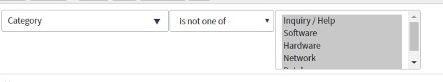

You could create a report on that table and apply a filter which says,
"Field Value" "IS NOT ONE OF" "All available options selected".
Example: I have set an invalid value in Category field to one of the incident records; and I have applied the following filter to see all the records having invalid category values:
I have selected all the available options present for Category fields with the operator "is not one of". Which shows me the records with invalid values:
