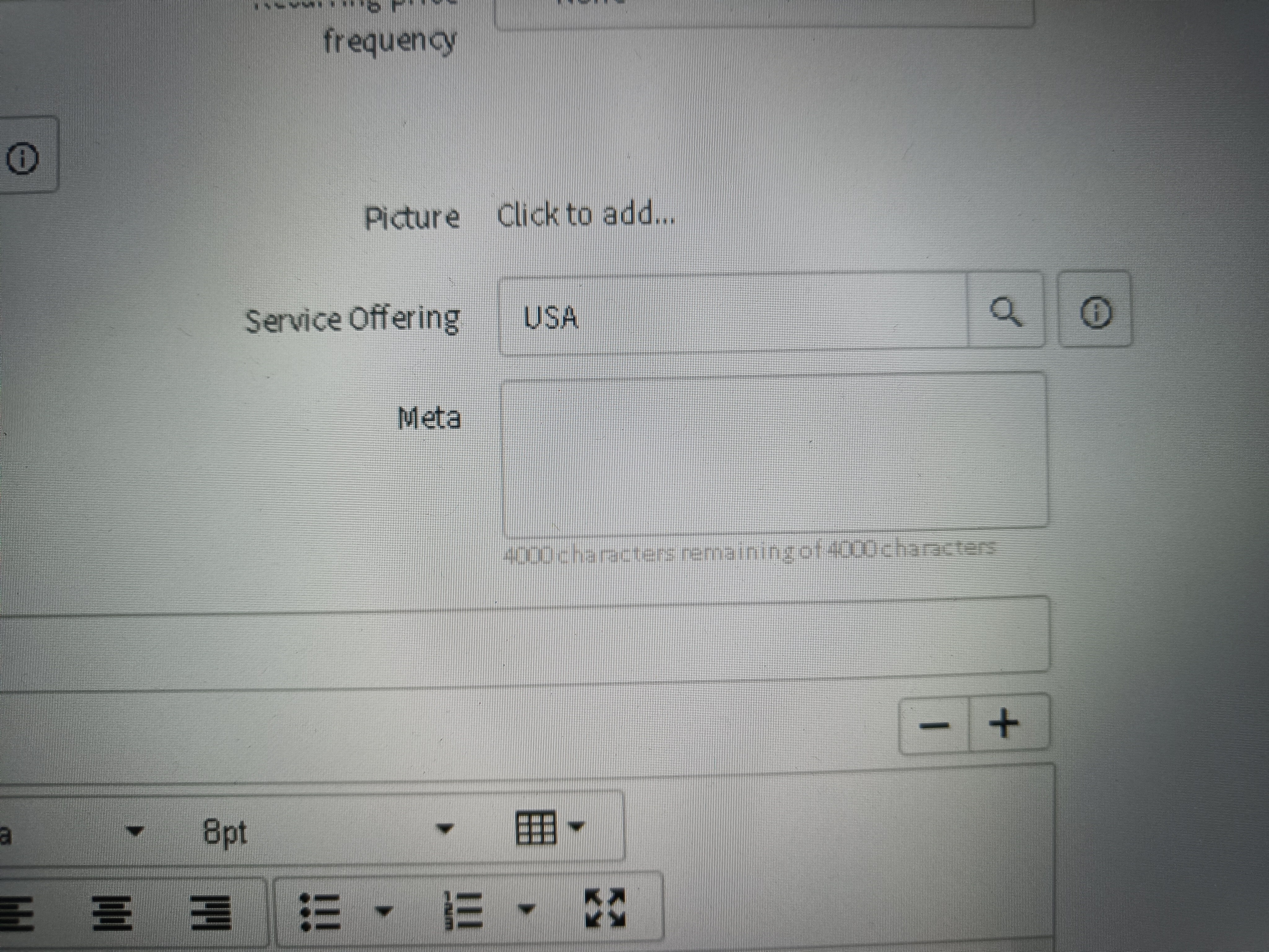

I have a requirement in service catalog like If the service offering is set to 'XXX' the following 'AssetCtask:Deliver/Install IT equipment'  task template should be deactivated. How it can be achieved?
Can we acheive it using OnSubmit Client Script?
