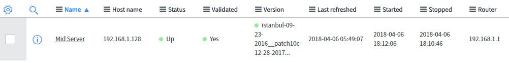

I am want to send incident ticket from SNOW to HP service management. HPSM is installed in Vmware and i have also installed and configured the Mid server in same Vmware. and checked in servicenow mid server status is up and validated, there is no issue with mid server. below is the screen show.
