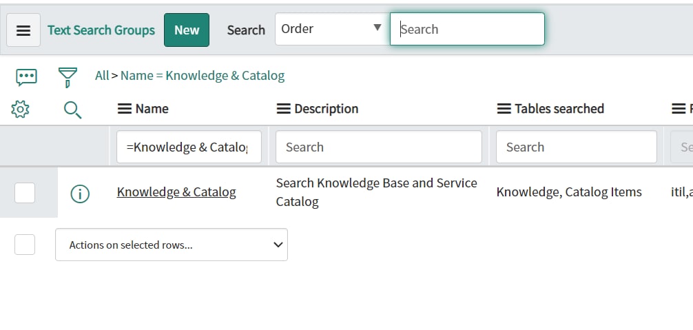

1) Navigate to "Search Group" module as shown below:
Search for Name as "Knowledge & Catalog" as shown below and open the same and scroll down to Related List named as "Text Search Table" and open the record for Knowledge.
Open this record and see if what conditions are listed here and this might be the reason Knowledge article are not getting searched.
Try running the same Conditions in the List view of Knowledge and see if the articles you are looking for is getting returned or not in the List view:
