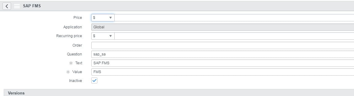

On a catalog item I have a question that is a choice list (drop down).
It consists of several values that each execute a different path in the workflow.
It turns out that 1 of the choices is not ready for production so I want to temporarily hide it or grey it out, etc.
I noticed that in the choice list there is a check box for 'inactive' [see attached].
When I select this, it does not appear to have any effect - the choice is still available and does not appear any differently.
1) What is that Inactive box for?
2) How can I temporarily disable a choice without deleting it (need sysID for later).
darius_koohmare
After setting inactive to true, did you flush your system cache as well?
cache.do into your navigator will do this.
