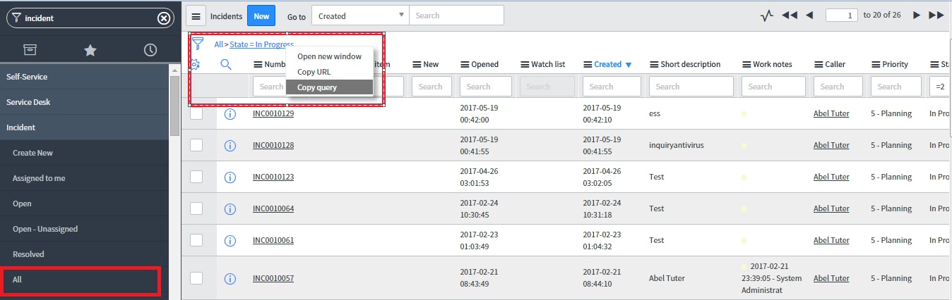

In the code shared above you can get your Query required by simply Navigating to the list view of incidents and filter the Records which you want to close and then Run the filter. Post Run Right click on the query and copy the same as shown below:
