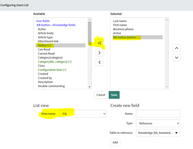

Hello Pavithra813,
I believe this is a scenario where you could use reference fields and perform dot-walking for this field in list view to display what you are looking for.
Please try the steps below and let me know if it helps.
  1. Create a new reference field in the sysapproval_approver table. (Use 'type' as 'Reference').
  2. Name it KB Author or something meaningful.
  3. Use table 'kb_knowledge' in the 'Reference' option in 'Reference specification' tab while creating this new field. So new field referencing the Knowledge table. Save it.
  4. Now go to 'Layout list' in your sysapproval_approver table.
  5. Select the correct list View name in which you want to display this column.
  6. Now click the newly created reference field. There should be a [+] next to it. Click the 'expand selected reference field' button.
  7. Now select 'Author' from the displayed list and add it to the right side 'Selected' columns list. Make sure to place it where you want to display it. Then click Save.
    Now if you go to the table list view and use the view name that we just edited, it should display the column as KB Author.author. Im unsure how you will be using it in your organization but this would work in this case.
