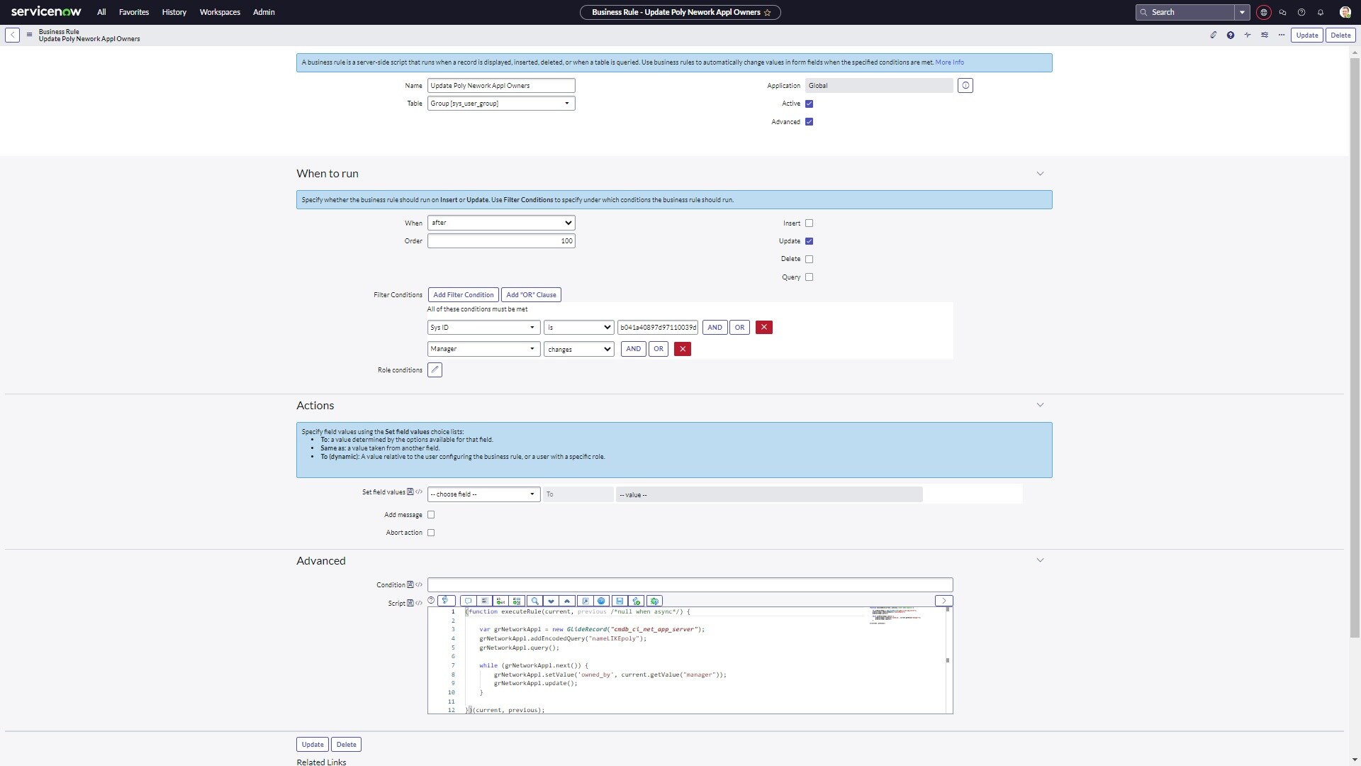

Craig Gruwell
Hi suuriya,
You'll want to use two different business rules to accomplish this.  Refer to attachments (of course your sys_ids will differ so you'll want to update accordingly).
Craig Gruwell
Hi suuriya,
