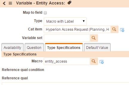

Create a new UI macro with above provided code. Now create a another catalog variable of type macro with label. In Type Specification tab select the macro you created.

You could use a UI Macro having HTML code for number input
<input type="number" step="0.01" min="0.01" name="numField" id="numField" max="100"/>
