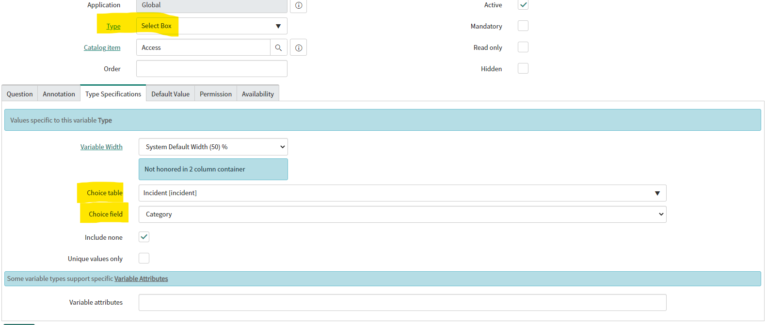

The issue you've described above for the duplicate category choice is happening because there is a value mismatch between the value of the Category choice on Incident table for 'service request' and the value of the Category choice variable on your catalog item for 'service request'.
The easiest way to make sure these are in sync would be to update your Category variable to be Type = Select box, then set Choice table = Incident and Choice field = Category:
If this answer is helpful please mark correct and helpful!
