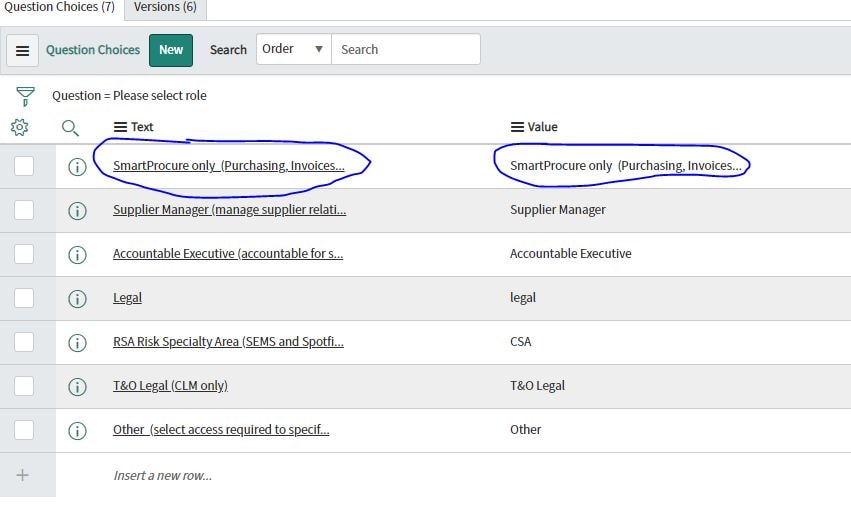

When the label and value of the question choice are same then I can see the french translation working but when the label and value are differenct then frensch translation is not happening...
I tried with choices,translated text/field, translated texts and ui messages.. nothing is is working.
Can someone help me?

You want to see the translation on the choice itself or on the label of the field?
Can you provide some screenshots so I can better understand your problem?

The blue one I have rounded That is getting translated to french but the remaining choices are not translating, but if the value and text I am keeping same then its translating.
Hello Tanmay,
Go to the sys_choice table, search for records where table = item_option_new and element = name of the variable.
Paste here a screenshot of that.
https://your_instance.service-now.com/sys_choice_list.do
You should be able to see, for the different choices, a value in English and other values in french.
Paste here a screenshot so we can see the values that are there.

Below article should assist. Basically you need to create multiple choices in each language in the mentioned way:
https://community.servicenow.com/community?id=community_question&sys_id=d9465f6f1b3e6c10ed6c9979b04bcbd8
