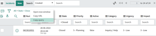

Filter condition: Apply  filter as below right and copy query and use in script as encoded query.
Script: Below script you can use in background script to open closed incident's
