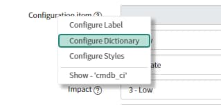

Right click on the dictionary and click on Configure Dictionary
Scroll down to the dictionary overrides and open the one on change request
Click on override Ref Qualifier and add this: managed_byISNOTEMPTY
SAVE.
