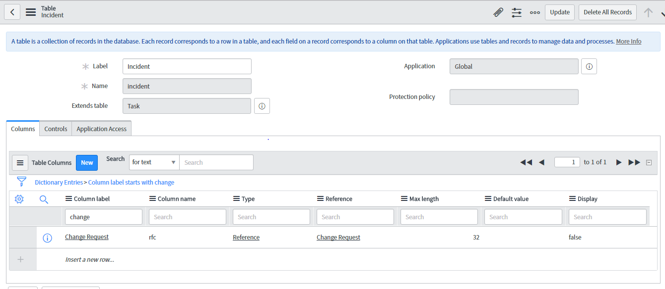

08-27-2017 11:26 PM
In your case there is no separate table-
Go to incident table there is a column named-Change Request.
This is a reference field that holds the relationship data-
08-27-2017 11:33 PM
Thanks all for the explanation , it is understood there is no particular table for relationship and the reference field takes care of that.
