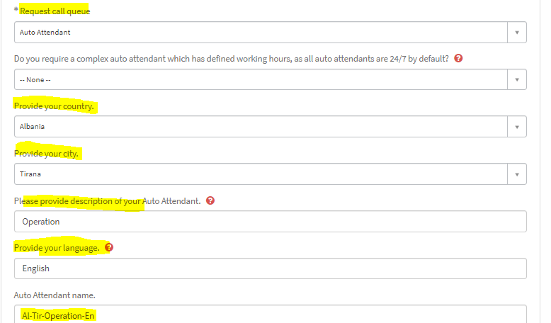

Requirement is to concatenate the string field
Hi Experts,
Requirement is to concatenate the five field values and display the value in one field
1.First part is From the first filed need to select first letter 'A' from the first word and First letter 'A' from the second word. I'm unable to achieve this >> Auto Attendant should give 'AA', If for example Call Queue should give 'CQ'.I'm trying it on on change client script.
2. And the next fields I had worked on it and I'm getting an expected result in Auto Attendant name filed but my aim is to get the value in Upper case for example result should be like "AL-TIR-Operation-EN"
and the final result including 1st and 2nd part I'm expecting is for Auto Attendant it should display as "AA-AL-TIR-Operation-EN"  and If user selects 'Call Queue' in first question Auto Attendant should be "CQ-AL-TIR-Operation-EN"
Kindly help me on achieving this
Thanks in advance,
Chaithra

Hi @Sumanth Dosapati
Thanks for the reply.
 The code is working good in background script, but when I applied it in client script instead of "AA" for Auto Attendant it is showing as "3" where 3 is a value, Request call queue variable type is "Select box". so that in the screenshot  3 is showing is based on value instead of text
Please have a look into it.
Chaithra
Hi
Request call queue variable type is "Select box". so that in he screenshot  3 is showing is based on choice number.
Chaithra
That is may be because you are using g_form.getValue() to get the Auto Attendant.
Try this
var value = g_form.getValue('request_call_queue'); //check variable name
var displayValue = g_form.getOption('request_call_queue', value).text);
Now you can apply the logic of getting first two letters on 'displayValue'
You can share your script if you are not able to get it.
