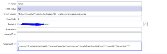

I'm trying to integrate with Kandji, and it required bearer authentication. I tried this with Postman, selecting bearer as the authentication type, and it worked. As shown in the screenshot below, I tried it through the rest message, but it returned an error. Does anyone know how to configure a rest message for bearer authentication?

Thank you for your response. I tried your solution, and it stopped giving the bearer token error, but now it is showing the above error even though I have the correct bearer token, which works fine in Postman as well.
