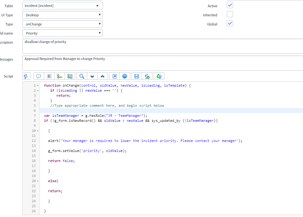

Hello All,
I am not very well versed in scripting at all and I need some help from the community.
I am trying to restrict the lowering of a priority on incident tickets by technicians (which increases the SLA).
I have created a role that I will assign to the Team Managers and I want to allow them to change the priority.
I have looked through various postings and thought the screenshot of the client script below would work but I was wrong.
Error:
We do NOT use impact and Urgency. We have 9 different Priorities (1-9)
So anyone (except a manager with the Team Manager role) would be unable to lower a priority and extend the SLA.
Increasing the priority would not be restricted.
Can anyone assist or is there a better way to do this?
Thanks in advance for your help.

‎01-11-2018 07:38 AM
Okay, let's try this....
Update line 7:
var isTeamManager = g_user.hasRole('JR - TeamManager');
Currently, the script is encountering an error because it does not understand g.hasRole.
‎01-11-2018 07:53 AM
Actually, I think this should work. Comment out line 7 and update line 8 to be:
if(!g_form.isNewRecord() && oldValue < newValue && !g_user.hasRole('JR - TeamManager')){
That should do the trick.
