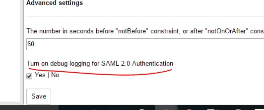

From Multi-SSO Properties, enable Debug:
Multiple Provider Single Sign-On - ServiceNow Wiki
This will start printing debug information.
This debug information is pretty descriptive to confirm on why SAML Response
