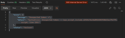

I am facing a issue in the Scripted Rest API where our resource we have used JSON.parse to drive our custom output from Approval, Requested Item and Change Request tables. When we try to hit our API, it returns the below error.

This error is observed mostly in JSON.parse command.
You can trouble shoot the script by adding log before the parse command to ensure that is the root cause. If possible share the script and sample payload to have a look

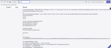

We have added log before the JSON.parse and tried to print the response.getBody and it was showing up the below response.
