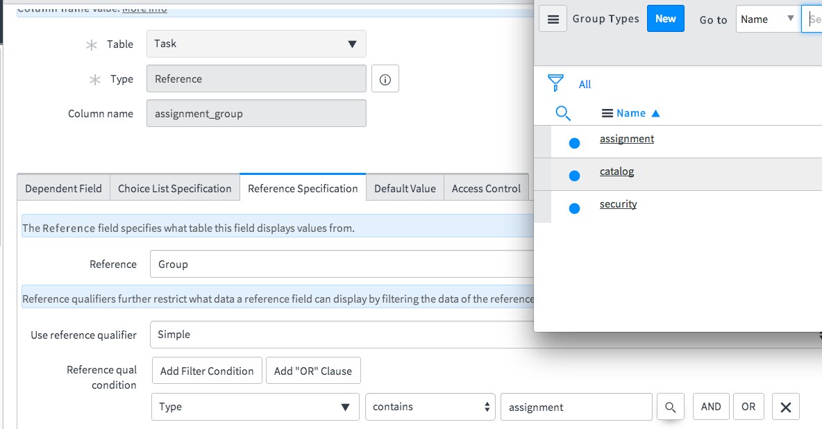

Just make sure you remember to use reference qualifiers to restrict assignment group references to exclude any of these new 'security' groups you would make. The group type works great for this.
