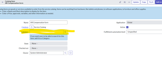

Whenever we are creating catalog items,
how do we attach this catalog item to employee center to be visible on portal?
When we are creating a catalog item, what should I be giving under catalog and category field??
I do not see the category I created under the Taxonomy Topic here
Hello @Vaishnavi35 ,
Issue 1: When u r adding the taxonomy pls make sure  ur Application Scope selected as "Employee Center Core". Only then u r able to see that edit button.
Issue 2: For to show Catalogs in the ESC portal. Simply u need to go to Topic --> Connected content --> Click on new select ur catalog item which u wanted to be visible in the portal.(All catalog items should be visible to u in drop down to select)
If u want to show specific category then u can select it inside this "Catalog and knowledge categories" .
